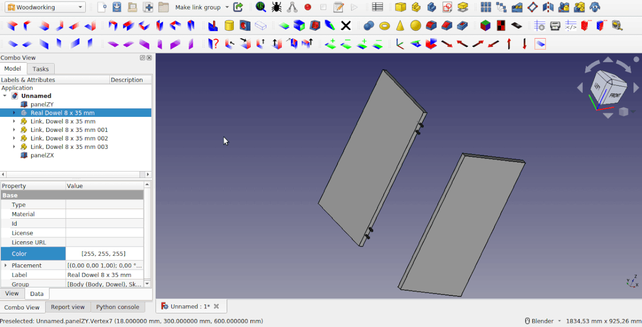

I can't guarantee, that I used exactly the same positions as in the example, but they would appear to have been similar.
manos wrote: Thu Jul 07, 2022 7:19 am Does anybody know anything more specific about this ?
Check out the "right hand rule," that explains why transposing one of the points leads not to a rotation but a 'flip'.

manos wrote: Thu Jul 07, 2022 7:19 am ....
Very interesting and useful. Does anybody know anything more specific about this ?
Hi manos, greetings to the Community!
Here is an animation showing an alignment with a "universal method"...
drmacro
Veteran
Posts: 9009
Joined: Sun Mar 02, 2014 4:35 pm
Re: Question on Alignment 2: Orientation
Post by drmacro »
I get it, understand learn the default tools...
But, these examples are the reasons I use Manipulator. So, just to show the alternates.
Select a face, Ctrl-select another face click one icon. Done.
Want is flipped the other way, click a checkbox, then click the icon.
Align the normals, a checkbox, then click the icon.
:roll:

domad wrote: Thu Jul 07, 2022 6:16 pm Here is an animation showing an alignment with a "universal method"...
Thanks Domad but is it safe to use it with bodies from PartDesign ?

manos wrote: Fri Jul 08, 2022 7:00 am .......
It is the oldest, safest and most stable method (not that the others are not) but unlike the others you learn to reason and understand "work plans" and 3D modeling (in the strict sense of the definition) by managing it appropriately "the virtual universe" regardless of the modeling software.
Here are some modeling examples whose sketches and bodies have been positioned in this way:
https://forum.freecad.org/viewtopic.php ... 80#p506513
https://forum.freecad.org/viewtopic.php ... 9db3e06714
