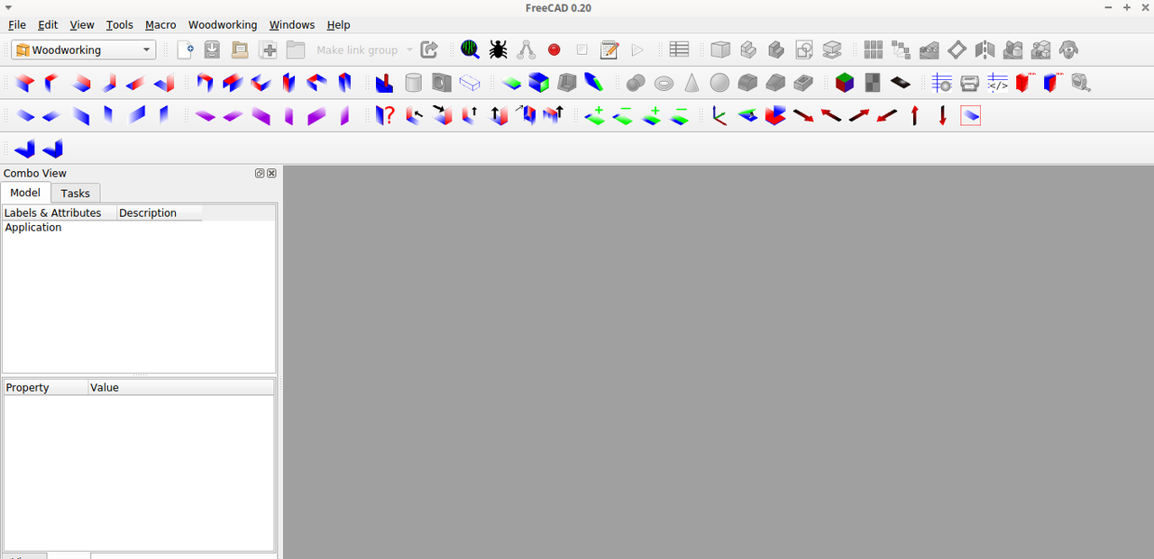

dprojects
Posts: 722
Joined: Mon Mar 06, 2017 6:02 pm
Location: Poland
Re: IconThemes
Post by dprojects »
yorik wrote: Wed Jul 06, 2022 10:52 am I would avoid XPM too, because it has indexed colors, it has no good transparency, etc..
The last 4th row has 2 icons. The 1st one from the left is XPM made with GIMP and the second one (the one from right) is the plain SVG made from the same PNG file with inkscape tool.
And yes I can confirm that the SVG look a little better, more dark colors, and the red edge is visible a little better. However I am not sure if this is worth to change? ;-) This is not so extreme difference ;-)
